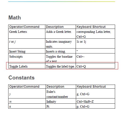

I don't know what I did but for some reason when I press Ctrl+Q, nothing happens whereas it used to let me cycle through the labels. Could anyone help me fix this?
Thank you.

Sorry, what is it "cycle through the labels"?
As in BASIC - goto lable1?
April 1, 2014
It is a built in shortcut.

I finally solved the problem. I tried to check what program was using my Ctrl+Q hotkey using a program called Windows Hotkey Commander (you can google it). Found out that Ctrl+Q is listed in my hotkey list but no program is using it (yes, even Mathcad). I figured that's probably from some program--beside Mathcad--that I uninstalled but that still managed to hog the hotkey.
I finally deleted the hotkey from the hotkey list (also using Windows Hotkey Commander; just uncheck the hotkey on the list) and now Ctrl+Q is working again on Mathcad!
Thank you Mr Mike Armstrong for your effort and for helping others knowing what Ctrl+Q is: a very powerful tool in Mathcad Prime 3.0! I really appreciate your--and others--help.
