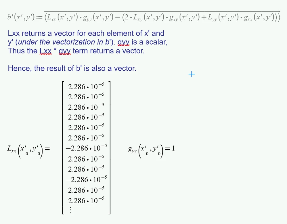

Sep 20, 2024 5:58 PM UTC
Hi, John.
I've just had a quick skim through your worksheet.  Wow, that's a lot of work, and it would take me a long time to get to grips with it.
However, I think I might have spotted the cause of your unexpected nested vector of 49x1 vectors:
Vectorization only applies to the vectors it sees in the variables/explicity defined matrices.  It does not apply to the results of an expression that uses those vectorized variables.  Hence, the behaviour you see in the clip above.
Stuart

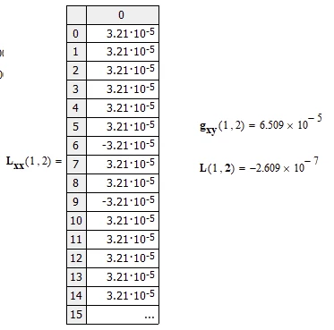

Sep 20, 2024 7:23 PM UTC
Are you sure that L.xx(1,2) should be a vector but g.xy(1,2) is just  a scalar?
I guess L.xx(1,2) should be a scalar, too. Otherwise it would be wrong to call an expression which contains L.xx using vectorization.
Its a good idea to test functions which expect scalar arguments if the result is as expected before you call them vectorized with vector arguments.
According the cross product I am a little bit confused what it should denote. As far as I know a cross product of two vectors is only defined for 3 and for 7 dimensions!

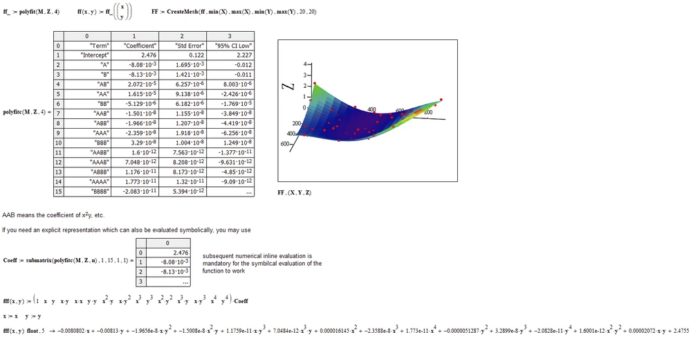

Just a comment on the polynomial fit of your data. I don't understand why the data is rounded down to 0 decimals before doing the polynomial fit.
Furthermore the coefficients for the polynomial fit could also be calculated by using polyfitc, the function defined via polyfit.
There seems to be no need for the spline interpolation.
But then, I have not looked in full detail in your sheet, so I may be wrong, indeed.
