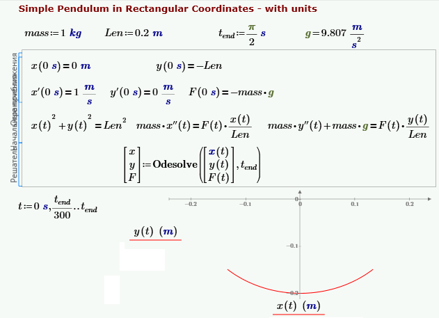

You can see in attach a solution one DAE (Simple Pendulum Motion) problem.
Without units - OK
With units - not OK
What is the problem?
Best answer by ValeryOchkov
Jakov Kucan wrote:
The issue has been fixed in Prime 3.0 -- coming out soon.
Thanks, Яков!
All OK in Prime 3:
8 replies
July 5, 2013
I can't see a good reason for your DAE to fail with units but work without units. I've attached an x-y version that does work with units, but it is formulated in ODE-only form, not DAE form (and if I change it to DAE form it fails with the same "incompatible units" error).

It seems to me that Prime can solve ODEs with units, but cannot solve DAE with units.
Jakov! Is it so?
