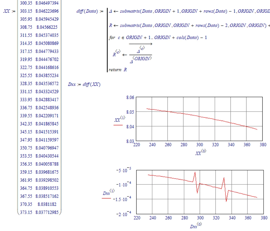

I'm trying to take the first and second derivative of my data set (frequency vs temperature). I've used the standard method to define a function via cspline- interpolation and take the derivatives. However, from the attached worksheet, it is seen that the plot of the derivatives have peculiar behavior and I'm afraid the result may not be reliable.
Could anyone make a suggestion on this issue, please?

Can't see all of your sheet. This is what I get with brute force differentiation:
I wonder if it would be better to approximate the curve with a mathematical expression (part of a parabola?) and then do the differentiation on that model...

Do you know why the cspline routine produces the spikes on the first derivative? I tried also with a higher number of data points and get the same issue.
23-Emerald V
As far as I know (regarding splines not much) spline routines just try to find a curve that nicely passes through all your data points. If you have a couple of 'funny' points, they will be included in the curve (Note that DJF's graphs appear to show these funny points!). So I guess there's no difference when you use spline curves or the raw data to calculate a derivative.
Modelling the behaviour with a mathematical function (as Alan reportedly did) will get rid of any funny points.
Maybe it's worth-wile to investigate how the funny points got in: was it the oven switching in or out?. If you remeasure the curve, do you get spikes at the same temperatures?

payman1-VisitorAuthor
Thank you, Alan.
Using the regress routine produces smooth results in both the first and second derivatives. It looks more reliable than cspline routine.
Here's a b-spline solution (prime 5 and pdf).
