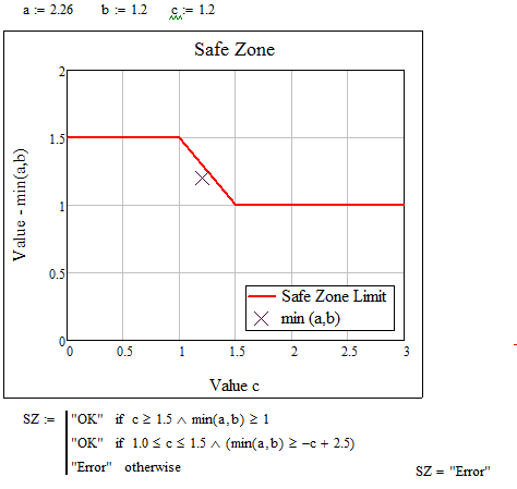

I am trying to figure out a way of checking that a specified value (min of values a & b) is in a "safe zone". Is there a way of doing this is in a smart way?
See attached
Regards
JXB

Thanks for the reply. You are right about the area above 1.5 for c < 1. I was doing one thing at the time. Startin with the easy bit!

One single value can't be in your zone - your safe zone is a twodimensional area, so you would need two coordinates to check if a given point is in the safe zone.
Maybe something like the following will do what you are searching for
BTW, your function SafeZone() has an error (2nd line) which does not show up in the plot because of the large stepwith (0.5) of your range cvalue

Thanks Werner. Spotted the error after posting the file
Teh attached (SZ) seems to be working!

As you had already defined your function SafeZone, I would't redefine the same function again in SZ but rather use the already defined function. Furthermore I'd prefer a function to yield the OK or Error message, so you could evaluate for different triples of values in the same sheet at the same time.
Your calculation of SZ does not consider the area above 1.5 for 0<c<1 as safe. But your safe zone limit graph suggest that this area IS safe. If its not you would have to change your function SafeZone, replacing the top 1.5 by infinity (ctrl-shift-z):
