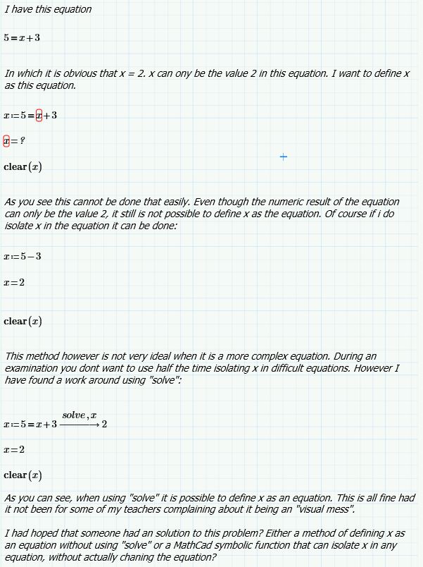

Hello all
I am sorry to say that this problem is not about a exciting, complex and never seen before math problem. It is more of a simple interface problem. I have included a document that describes the issue, but the essence of it is that i want to be able to define a variable as an equation. More specifics in the document.
Many thanks
/Mürer

Here you go

I think I see what you're trying to do.  See if the attached file helps.
(It's Prime 3.0, 3.1 should open and run it.)

I must admit that I am a pure MathCad rookie in regards to any of the even only slightly more advanced features. My abilities are limited to Solve, Float and Clear. Even though I can to some extend see what you are doing, I very much doubt that my old-school non-Mathcad trained teacher are going to feel that your solution is more straight forward than just using the "solve" method i described in my file
Richard Jackson
You are certainly correct in respect to x=5=x+3 makes no sense. But I mean it more like x is defined as 5=x+3. With your method I do not get the benefit of actually defining x. Also I essentially introduce another variable called "Equation", which my teacher might not understand the point of. Also i would have to clear() that variable after each calculation.

Understand that my teacher is used to getting handwritten(although calculated with a calculator) solutions to equations in the like of just:
5 = x +3
x = 2
Which is why he is complaining about the "messy state" of my MathCad documents. I appreciate very much your ideas but it is unfortunately not really what I am looking for.
/Mürer

Unfortunately, what you want is not possible. If you write
5=x+3
Mathcad cannot know what you want to do with that. On a piece of paper you could write something like "given the equation above, solve for x", but Mathcad also cannot interpret arbitrary text strings to figure out what you want. In any computer algebra system you have to give very specific instructions, in a very specific syntax. Until such time that CAS software can interpret arbitrary text strings (or read minds ), you will be stuck with that.
The closest you could get is with Mathcad 15:
But if what your teacher really wants is
5=x+3
Therefore
x=2
you will have to solve in Mathcad, and write your reports by hand.

Yes I see your point and agree fully. Mathcad and any other CAS program needs exact instructions to understand what to do. Problem is that my teacher is not happy with the "telling the program what to do" part of the equation(solve, float etc). Your suggestion about solving in Mathcad, but writting on paper is a solution of course but that would defeat the purpose(in my case at least) of using Mathcad. The 2 main reason for me to use Mathcad is firstly to not having to write down equations twice(ones on the calculator and once one the paper) and secondly to use Mathcad ability to remember results(definitions) which is very handy during a series of many equations. At the exams the time limit is really the difficult part. Being able to shave off a minute here and there is a huge advantage.
Fred Kohlhepp
Ah I see how it works now. Thank you. I will show it to my teacher, but I have a feeling that he wont accept it. From the perspective of an "pen and paper" teacher he most likely will not like MathCad language.
Anyway thanks again guys
/Mürer

In Mathcad 15, by judicious use of "hide keywords" and "view evaluation as" I can get this
Prime (at least 3.0) doesn't have that much formatting flexibility.

That is actually a quite neat solution you are proposing there. That would solve my problems without impeding the workflow too much. Only thing is that you can actually see the collapsed area line when printing out. I found an another PTC forum thread that solved that problem:Solved: Hide the "collapsed region" lines when printing a ... - PTC Community
But that must have been in an another version of MathCad or MathCad Prime because I cannot right click on the lines nor can i find any "properties" menu anyway else. Still That could be the solution. I must consult my teacher.

Mathcad 15 is far more powerful than Mathcad Prime. Most of us still work in Mathcad 15, because Prime lacks so many features. One such feature is that you can't hide the line. You can in Mathcad 15. The current release of Mathcad 15 is pretty stable. It does crash sometimes, but not often. Just save your work regularly, and make a backup by copying to another folder, because very occasionally a crash will corrupt the file. However, we have seen Mathcad Prime files that were completely trashed posted to the forums, so I would not say that Prime is any safer in that regard.
You can download the latest version here: Thank You for Your Interest in PTC Mathcad 15 | PTC. Point the license wizard at your Prime license file.
