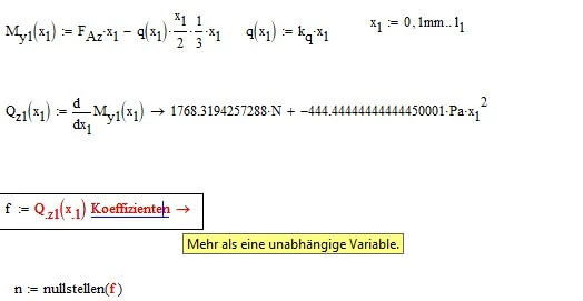

Hello, I have a beam with a triangular line load. For this task I wanted to visualize the existing Mb curve using a My curve. I created this with partial functions. So far so good. As a further step in my task, I wanted to use Mathcad 15.0 to determine the location of the greatest bending moment. From a purely mathematical point of view, this corresponds to zeroing the 1st derivative (lateral force). Everything is clear from the logical understanding to the procedure. Unfortunately, from this point on it does not work completely smoothly and without problems. Because I have created a new definition with the derivation and function including the run variable specified for the derivation. Then I wanted to use the symbolic commands "Coefficients" to output the existing values ​​and to have the 2 possible zeros displayed again with the additional "Set to zero" function. Unfortunately, when performing these steps, I always get the error message that there is "more than one independent variable". Although the designation and definition of the entire variable including units would be correct. I have attached the file including screenshots of the problem addressed. As an appendix for my problem, I also wanted to ask what it is all about when I have values ​​calculated using the symbolic equal sign and these are completely overflowing with various units. After doing some research I saw a post here in the forum and have the same problem. (https://ww3.cad.de/foren/ubb/Forum479/HTML/000449.shtml) Is there already a solution for this or is it just the behavior of MC? I would like to thank you very much for advice or help. Unfortunately, I'm already very desperate and after researching Google etc. I don't know what to do next. Many Thanks.

The main problem here is unfortunately the usage of the units.

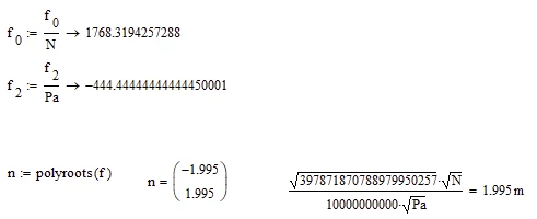

The "coeffs" command correctly works symbolically as you can see if you symbolically evaluate "f":
The red error is because the numerics does not allow vectors or matrices where the elements are of different dimensions and f has three different ones - force, dimensionless and pressure.
This is also the reason why the "polyroots" command fails.
You may make all elements of "f" dimensionless by dividing through the appropriate units (you must evaluate symbolically!) - then "polyroots" works ok and gives the same result as your following alternate method:

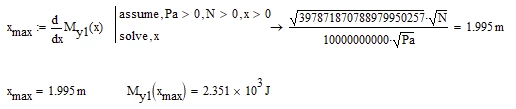

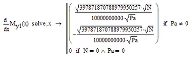

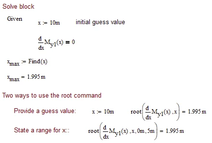

    You may use the symbolics to directly solve for zeros of the derivative:
    The symbolic correctly realizes that Pa=0 would be problematic and N=0 yields the simple solution 0.
    So you can tell the symbolic via the "assume" command, that Pa is positive:
    If you are only interested in the positive solution, you can tell that the symbolic again using "assume", but you also must tell it that N is positive, too, otherwise it would not be able to decide if a solution is positive, negative or even non-real:
  • But you don't have to use the symbolics at all. Mathcad provides numerical means for solving equation with the solve block and the root command

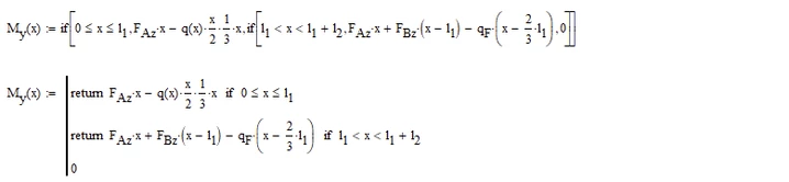

first of all thank you for the help. But for the function q(x.1) i created it to set/create the bending moment function My(x.1) for the first part of l.1. Because if i cut through a certain length x1 there is not q=4kN/m at the peek of the triangular. Its (q/l.1)*x1 for the function.

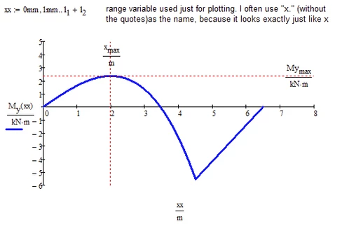

And i saw you used simply "x" for the bending function. But how do i show the bending moment with the appropriate units for the diagram? Do i have to use 2 functions? 1 for solving the value of the maximum value and 1 for the illustration on the diagram.

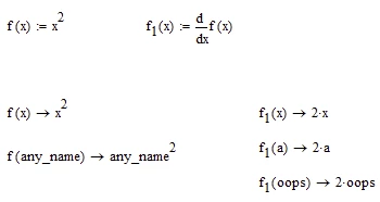

I understand that you want to define a piecewise defined function. Range variables are OK for plotting that kind of thing, but not for calculations.
When you define a function, the name of the formal argument does not matter at all!
and is does not matter at all, if and how x or dummy are already defined in the worksheet. This only matters when you evaluate the function using the variable as actual/current argument.
To create a piecewise defined function you can use either the if command (similar in syntax to the "if" available in spreadsheets) or the if-statement from the programming palette.

But as I see it you don't need symbolic calculations at all. A numeric solve block or the numeric root command seems to be all thats needed to get your maximum.
To indicate the units in the plot, you can divide the variable and function by the appropriate unit (use a range variable for plotting when you do so). I assume meter for x and kN*m for M.y:

You did it yourself in the sheet! Simply evaluate the function using a formal argument which is still undefined.
You may limit the number of valid digits using the "float" command.
Be careful with the use of "float" when you make actual symbolic calculations because it not only limits the digits for the display but also limits the precision of the whole calculation.
Unfortunately, as already indicated above, you won't be happy with the result if you use a function which is derived from one using branches (if). You might get errors like "this value must be a scalar" or a cryptic "pattern match exception".
I guess that there is no way to symbolically show a function which uses if-statements. There are workarounds by defining the function using boolean expressions or the Heaviside function Phi instead of the if commands, but the results looks quite unclear and clumsy.
But if the function does not use any "if's" like the test function f you defined at the ned of the worksheet, the symbolic will be happy to display it using any formal argument you provide:

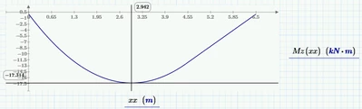

Since I used to do this for a living and I'm stuck at home from the virus, I took a shot at this (using Prime 4.0 Express.)  I don't like your graph of moment!
I don't think you can get a reversal like that with this loading.
Mine looks much different.
Attached is Prime 4.0 sheet (and pdf.)

The graph of the bending moment attached in my file is correct. I checked i with the given solution option from the book.
And secondly it goes to zero with a linear function and function third grad due the triangular track load.
