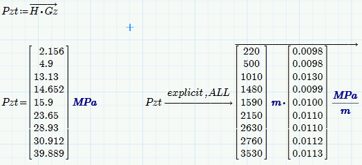

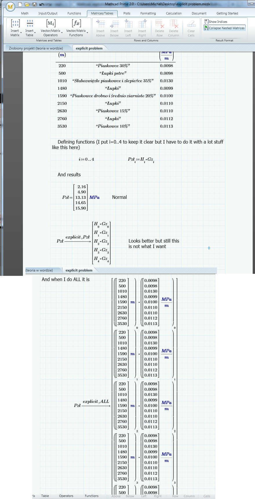

Can any of you solve this problem, I also tried putting Hi, H0 nothing works
is there any chance to make it more good looking?
I mean the matrix is too big, instead of showing 1st, 2nd ... item of this matrix

Mathcad's explicit,ALL is right - the results are derived by picking a specific element from a vector and this is shown.
I know what you want to see, but it looks you can't get it.
The closest I could come up with was using the full vectors and the vectorization operator. See attached.

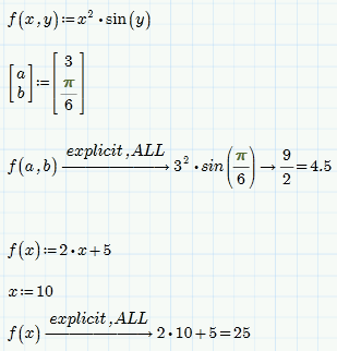

September 15, 2013
Just realized that "explicit" works differently in Prime and does what you want 😉
