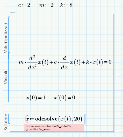

Dear all,
I'm new user of mathcad prime.
I'll try to solve a differential equation reported in the examples but I obtain this error message.
How can I fix it?
Regards
Stefano

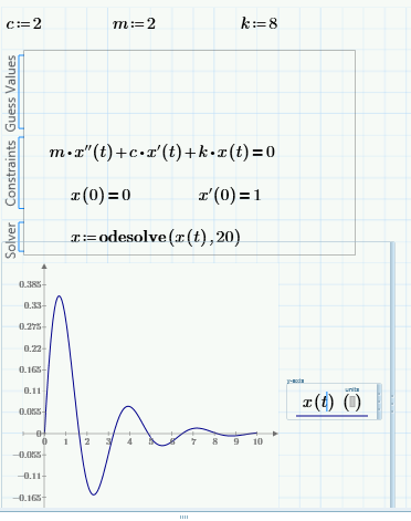

1st - if you can, upgrade: Prime 2 (as I have is just workable) Prime 3 looks a little better.
otherwise you may be better advised to load Mathcad 15 - the license for prime should allow this.
Prime 1 was very 'difficult'...

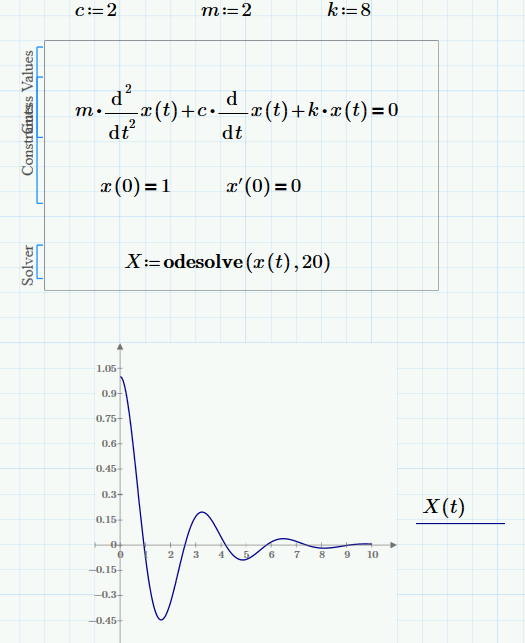

if you insist on using P1, try this (it does work in P2).
Note that the ' needs to be added from the operator menu on the maths tab.
Typing it directly doesn't work - though there may be short-cut keys.
I would include the worksheet, but if you have P1 you wouldn't be able to open it.
regards
Andy

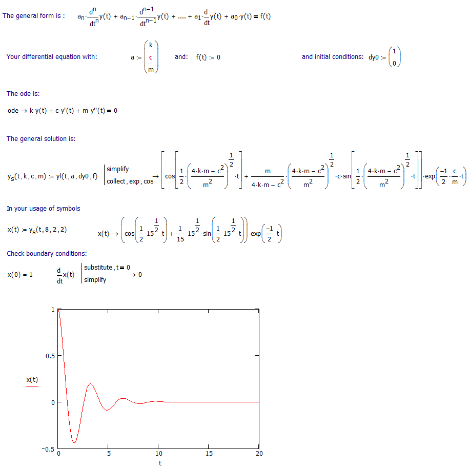

Better still, if you (can) have access to mathcad 11: Using this A classical math problem: differential equations
Check.

derivatives with respect to x?? dx(t)/dx ??
