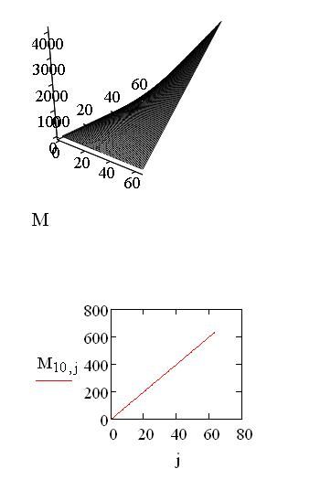

my Problem is to display 3D Plots. Disabling the boarders will show my plot until i scroll in the document.
I found another solution to reduce color depth to 16 Bit, but Catia dislike this changes not even Wn7 Aero runs on 16 Bit.
I noticed this problem on various machines running MC14 and MC15(trail). Prime1.0 does not support 3D plots
Did I mixed up a bug with a feature? What's the point anyway?
Is there a workaround for the 3D Problem?
Thx

July 30, 2011
Udo, hello!
In what version Mathcad you work?
...I tried to uncheck borders and modify compatibility. No luck...
Try to contact technical support PTC, creating a new "Case" here: https://www.ptc.com/appserver/cs/case/case_logger.jsp
P.S. Plots created in the document are as follows:
