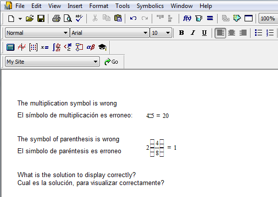

I have a problem viewing , multiplication symbols and parentheses seen incorrect  , as shown in the image:
(Tengo un problema de visualización, los símbolos de multiplicación y paréntesis se observan erróneos como se muestra en la imagen)
I would appreciate your answers to solve the problem.
(Agradecería mucho sus respuestas para solucionar el problema.)
Note: I'm using windows and Mathcad 15I'm using windows and Mathcad 15
Nota: Yo estoy usando windows 7 y mathcad 15.

More likely that the symbol font is corrupted and needs to be reinstalled.
23-Emerald V
September 8, 2015
Check that you have the Mathcad UniMath font installed.
See thread https://community.ptc.com/t5/PTC-Mathcad/Unimath-not-Installed/m-p/284449#59496
ngerardo1-VisitorAuthor
September 13, 2015
Perfect!
Simply double-click the file and accept.
You're great
