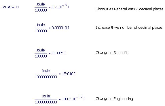

November 8, 2011
Like below.
Mike
November 8, 2011
You can also use a more appropriate unit, or make your own unit
