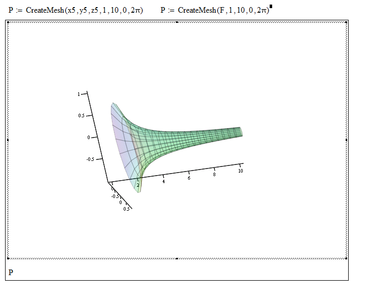

We are getting into integrals etc and have managed to create some neat shapes. However, trying to create a Gabriels horn using parametric equations results in an error message of "divide by zero". Yet, extracting the y and z values on their own does give values not equal to zero, but trying to plot them even on their own gives the same error.
What are we doing wrong. Can anyone help.

3D plots are always a problem, CreateMesh is usually the easiest way to generate the data for the plot.
Both forms will give the same plot, just enable/disable to see any difference
Regards
Andy

You can't plot z5 alone, you would have to use x5 and y5, too. You may do it as in the attached.
But here you would have to set the limits of the parameters in the 3D plot format menu, tab "Quickplot data" amd thats a bit cumbersome. So I think using Createmesh as Andy has shown is the better way and gives you more control.

Thanks guys. I tried the CreateMesh and I like it. Does have certain benefits and also allows an alternative method to produce answers. Appreciated.
