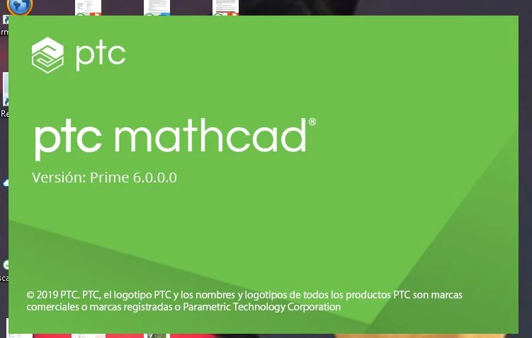

Good morning, I would like to know if anyone knows why this event happens, it turned out that I was working in mathcad 6.0 and my computer turned off, once I started it again I tried to open mathcad to continue with my programming and the program never opened again, it only opens that green window and then closes.

Some Prime administration got corrupt. You can most probably fix that by deleting (or, if you're unsure, renaming) the file:
C:\ProgramData\PTC\Mathcad Prime\MathcadPrime.exe.Config
Prime will recreate it if it doesn't find it.

Also read this tip - "Mathcad Prime does not launch after the initial splash on Windows OS": https://community.ptc.com/t5/PTC-Mathcad-Installation/Mathcad-Prime-does-not-launch-after-the-initial-splash-on/m-p/729884
