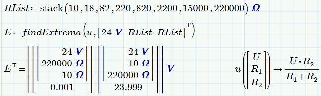

There is no way to restrict a variable to a set of values (unfortunately there is no such construct as a set in Mathcad, just vectors). Unless the problem is fairly easy to see what values to take (like the points Alan had posted) you would have to write your own routine which cycles through all possible values to find what you are looking for. Even more trouble if you add tolerance.
July 31, 2013
Just found that some months ago you had a similar question concerning tolerance values and you used Prime Express 2 at that time.
You could use the findExtrema() routine I provided here http://communities.ptc.com/message/199660#199660 and feed it with your vector of values instead of R1 and/or R2 which were resistance vectors, too, created by tolVec() [see below].
If you wish to combine your list of restistances AND tolerance, it should be not so hard to rewrite tolVec() to take vector arguments instead of scalars, if you are interested.
BTW, the following is what Alan was talking about (I didn't bother entering the full list)
The unit Volt at the end of vector V is wrong, its a Prime bug. It belongs to the min and max values (0.001 and 23.999) only.
You may have noticed that error already in the last thread (shame on me - I hadn't).

Now, if R1 and R2 are introduced in the Vsplit function and evaluated, a matrix (n x n) representing the values of Vsplit is obtained.
Unfortunately not! If you put two vectors R1 and R2 into a function Vsplit (and you would have to use vectorization) you will only get a vector of the same dimension n as a result. Only the k-th element of each of both vectors would be combined.
So you would have to write your own routine to combine every value from one vector with every value of the other to get your n x n matrix to look for the extrema.
This is basically what my function findExtrema() from the aforementioned thread does, but more general in as much as it would take an arbitrary function and and arbitrary number of variables (vectors or scalars) to cycle through.
After all this brute force method of an exhausting search is limited by the number of combinations as it will take too much time with more variables and larger vectors . In this case we would have to resort to more intelligent algorithms and Richard once suggested simulated annealing (http://communities.ptc.com/message/208841#208841)
