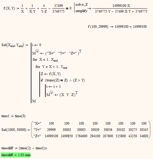

Did you look at Valerys post? It seems that Mathcad is not good at solving diophantic equations and so all I can think of is to try it with brute force like Valery had shown. Look at the attached. It seems that there are quite some solutions for X=100. Calculation time quickly grows if you increase the endvalues for X and Y (the parameters of the function Sol). As you can see in the screenshotmy machine is rather slow 😉 So good luck and patience.

It is one solution in/for Mathcad - in/for an engeneering office Or you would like to have one integer solution!?
December 12, 2012
One set of integer solution seems to be 7722793 / 197 / 1 for X / Y / Z.
But Mathcad's Find seems not to be able to find it using constraints like X=trunc(X), etc.
Strange effect with symbolic evaluation without guess values. Why does MC solve for Y?
