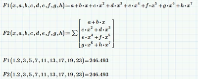

Of course, if you're desperate, you can always call the help of good-old sigma:
(Sure, there's a far more simple method to define this function, but the above is an example of how you can get verticality to a horizontal function.
