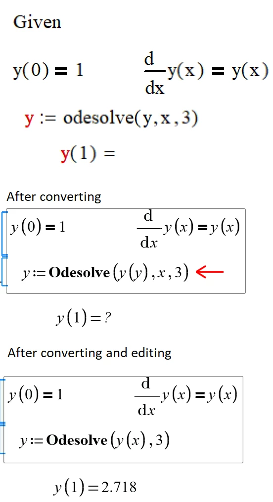

I have converted the file and a little edit it. See please the picture and the Prime 4 in attach.
May 20, 2018
One simple example:
May 20, 2018
Ah! A simpler example always is better! Even though the pictures are far too large, again!
So you should not only edit the converted Prime sheet to get the correct syntax for Prime's "odesolve" but also edit the Mathcad 15 sheet to get the correct MC15 syntax (the function name y is not used as argument of odesolve in real Mathcad) 😉
Unfortunately this simple example does not relate to your original file where it seems that you used the correct syntax. What did you change in Prime there to make it work (I am sure too lazy to compare myself). Did you change something else other than using real units, writing the derivatives using the prime symbols and adding the number of steps?

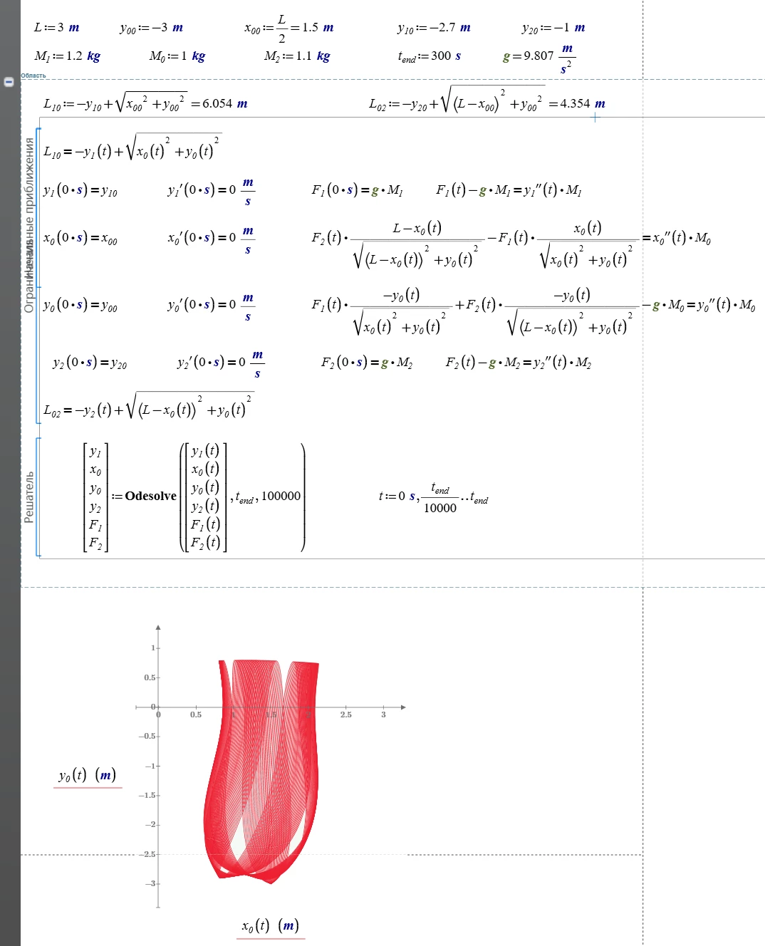

The system consists of four differential equations and six unknown functions. F1 and F2 are indefinite. Gravity acceleration was not dimensionless. Furthermore the conditions
should be respected.
May 20, 2018
Sorry, no problem in Prime. See please one fine solution

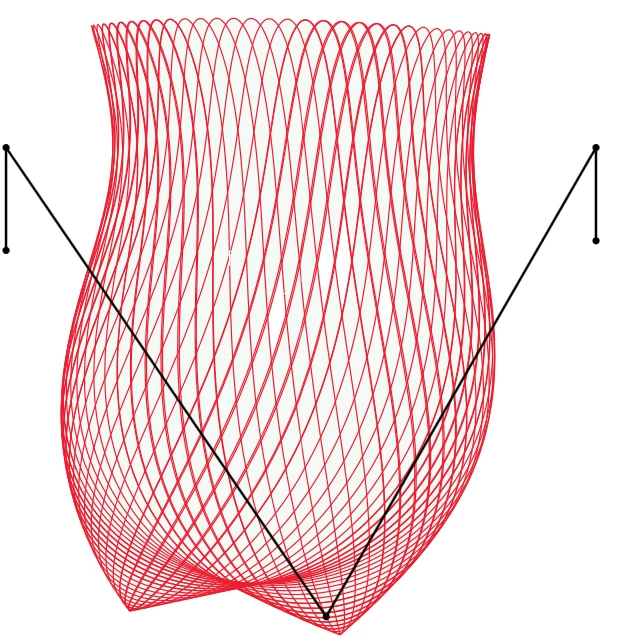

May 21, 2018
Mathcad Prime has new solver.
I think Mathcad 15 solver has an error and cannot solve my problem. Prime can. And with units! Or some others?
But Mathcad 15 can solve more powerful problem - see please the attach/ Strange!
