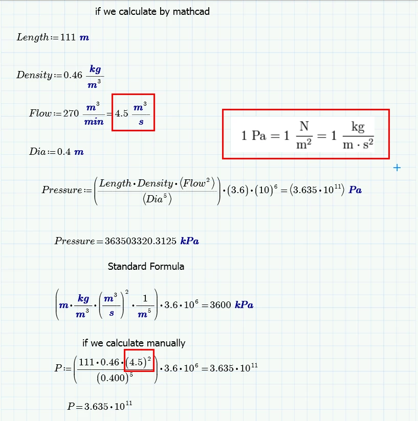

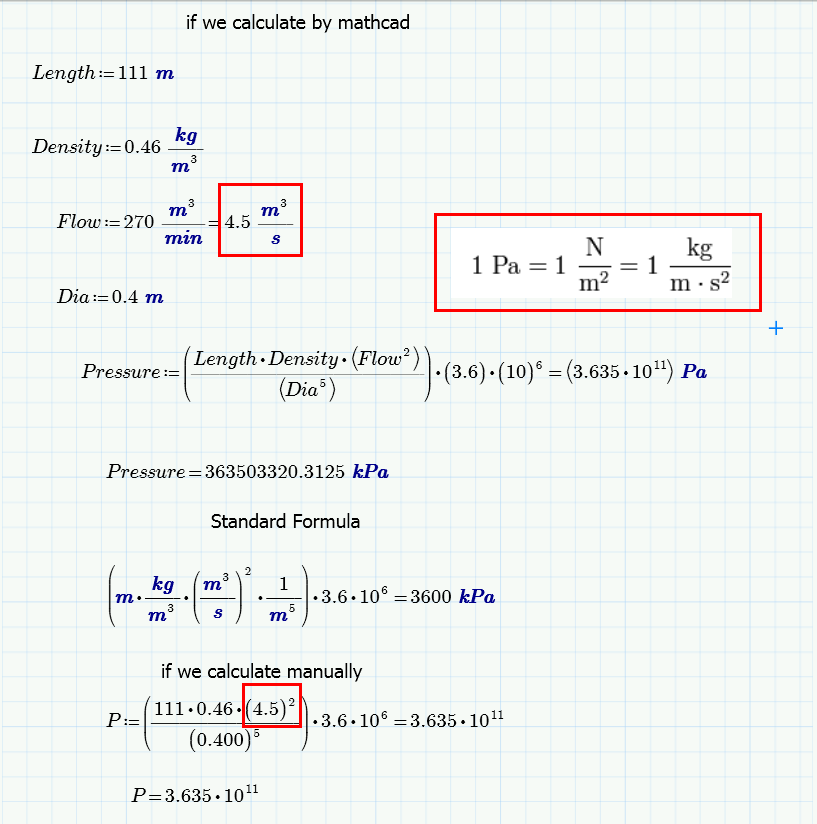

I'm trying to do a back pressure calculation in Mathcad Prime 3.0 but when I write a formula and declare the values of the variables, i get a wrong result from what I get in the manual calculation.
Had attached the Mathcad sheet with relevant info.
Can someone help me?
regards,
Amarkarthi
Best answer by VladimirN
Please see attachment:
P.S. About "Pascal" unit: http://en.wikipedia.org/wiki/Pascal_(unit)
VladimirN24-Ruby IVAnswer
January 6, 2014
January 6, 2014
Thanks Vladimir..
