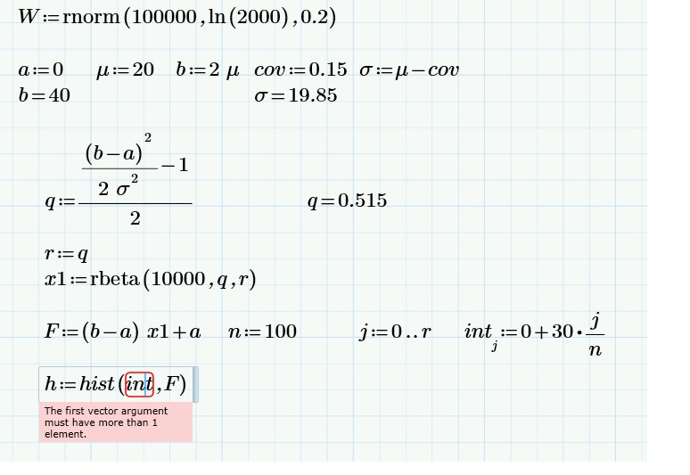

Error: the first vector argument must have more than 1 element

I am completely lost here. any help is appreciated.

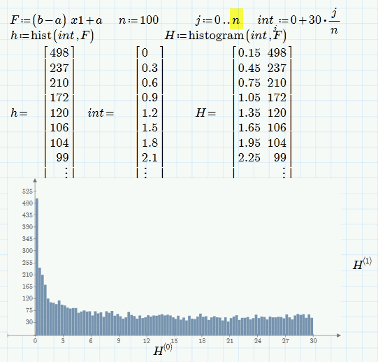

Please don't post just pics, always attach the worksheet, please.
I guess it should be j:=0..n and not j:=0..r
March 27, 2014
file attached.
Werner_E25-Diamond IAnswer
March 27, 2014
OK, so it seems to be that typo, as I thought.
