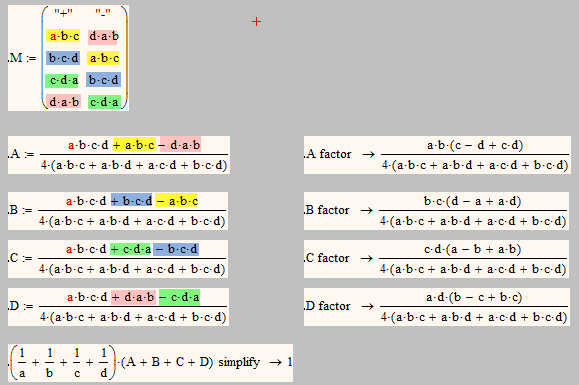

Nice to hear. And you can even make your solution to be better symmetrical by a very similar method and still an infinite number of possibilities:
Chose an arbitrary expression in your constants a,b,c,... which is NOT symmetrical in those variables. You could simply chose "a" but for demonstration I have chosen "a*b*c" in the example below. then write in the first column (you don't really nedd that matrix, its just for clarity) the n-1 cyclic permutations of that expression) This first column represents the expression which later are added to the (all equal) solutions (to keep things tight I will add them to the nominator). In the second column you write the same expressions as in the first column but shifted. These are the expression which will be subtracted. As every expression is added once and subtracted once they cancel when you add your A,B,C,... With this method you do not have to distinguish between an odd or even number of variables.
or using the simpler expression "a"

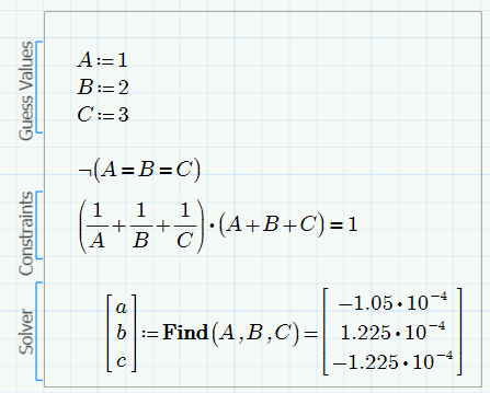

Oh, nice! That's a quick solution. Loi, you could also use the solve block to solve for it. But as Richard pointed out, there is an infinite number of solutions, so the initial guesses matter. This is just one solution.

In fact every solution to the problem you solved will consist of two variables with different sign and same absolute value while the third variable may have an arbitrary value. You can see that this is the only possibility to satisfy this equation even by solving symbolically.

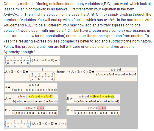

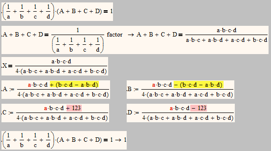

One easy method of finding solutions for as many variables A,B,C,.. you want, which look at least similar in complexity, is as follows. First transform your equation in the form A+B+C+..=... Then find the solution for the case that A=B=C=.. by simply dividing through the number of variables. You will end up with a fraction which has a*b*c*.. in the nominator. As you demand A,B,... to be all different, you may now add an arbitrary expression to one solution (I would begin with numbers 1,2,... but have chosen more complex expressions in the example below for demonstration) and subtract the same expression from another. To keep the resulting expression less complex its better to add and subtract to the nominators. Follow this procedure until you are left with zero or one solution and you are done. Symmetry enough?

Many thanks for the following :
This procedure is very helpful to me.
