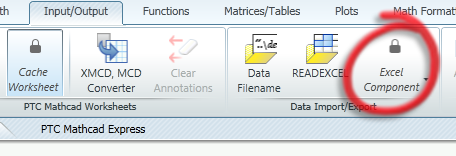

Do you see this?
This would mean that you have no valid license and your trial period is over - you are using Prime Express.

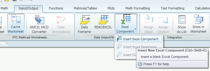

In the full version it should look like this

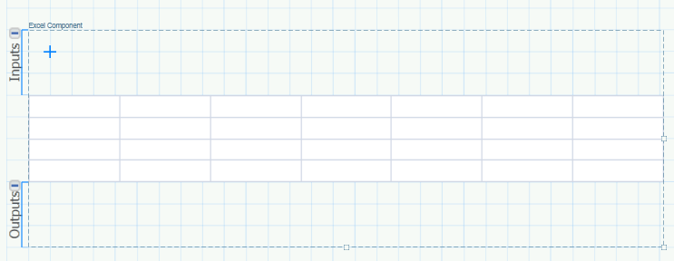

and if you click Insert... you get a template like this
In Express you should still be able to use READEXCEL() and WRITEEXCEL().

Hi Werner, is not this problem. I have a full academic licence and it is fully functional, i..e, there is no locker in the excel or any other button of my interface. In my version, when I click on the Excel Component all items in the dropdown menu are grayed, i.e., disabled.
