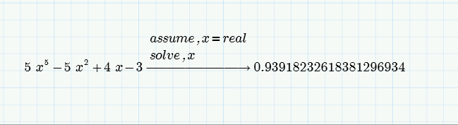

hello everyone,
i'm using prime 2.0
i want to exclude 2 of my 3 solutions which are non-real ...
I'm not really familiar with the Keywords and Modifiers,so i tried the "assume,var=real
which made everything only worse.....
i have searched a lot on google and elsewhere but couldnt find a solution for that problem....
maybe someone here can help...
thx in advance

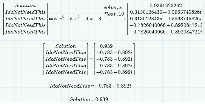

Best answer by ValeryOchkov
fronz penner wrote:
i tryed hard...
but i cant see that work...
Variables in your formula (the solution of equation) must have numerical values!
And second.
Please send npt bmp but png or better mcdx files.

May be this is a help for you:
October 28, 2012
To use Valery's example:
Regards
