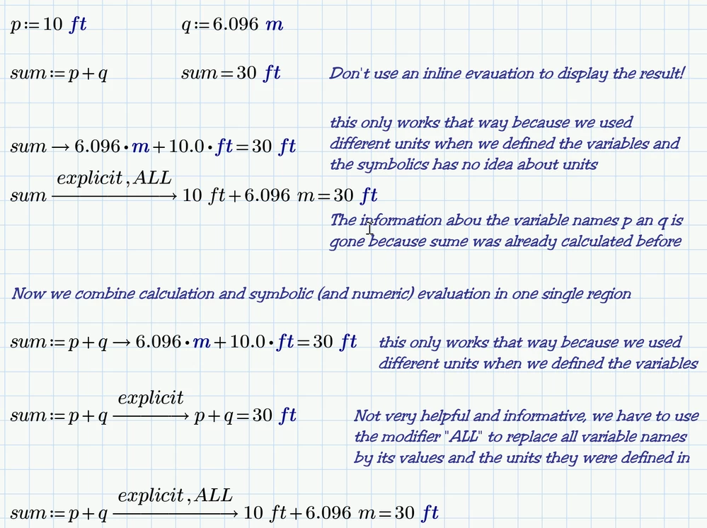

Expand on requirement in Mathcad Prime
Instead of simply stating the equation with its result how can I should break it down to show the specific values assigned to the variables and how they contribute to the final result. for example if I have p:=10 q:=20 I want to show r:= p+q=10+20=30 is this something i can do?

here is a short example on how to do it.

Use symbolic evaluation with keyword 'explicit'

Oct 16, 2024 7:42 AM UTC
Raiko
Oct 16, 2024 11:42 AM UTC
Here is another example with some explanations.
If I remember PTC's plans for future versions correctly, it shouldn't take another 10 years (as Raiko fears) until you can hide keywords in Prime, just like you always could in the real Mathcad (you could also replace the arrow with an equal sign there).
Of course, it could be made neater looking in old Mathcad
