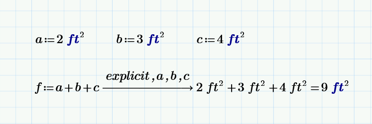

I understand the basics of explicit functions in MathCAD, however I am not able to figure out how to have an equation list the numerical values of each variable included in an equation. For instance, I am trying to calculate the total surface area of a concrete storm sewer junction box to determine the total formwork needed. The total surface area would be calculated as the sum of the exterior/interior 4 sides and exterior/interior top and bottom. The following is an example of my workflow:
a=sides=2 ft^2
b=top=3 ft^2
d=bottom=4 ft^2
f=total=a+b+d
I would like the valuves of a,b and d listed in my equation. When I attempt the explicit calculation I type: f=a+b+d, explicit,a,b,d. The result I receive is: f=a+b+c,explicit,a,b,d-->a,b,d=9 ft^2. How can I have the explicit function show: f=a+b+c=2 ft^2+3 ft^2+4 ft^2=9 ft^2?
The tutorial sheets in MathCAD do not show how to have an equation show the values, only the operation shown (i.e. F1=1, A1=2, F1/A1, explicit, F1, A1 --> 1/2=0.5)

Best answer by AlanStevens
Scott Horowitz wrote:
... how did you get the arrow to display in the SA calculations at the top? ...
Just use the Symbolic menu (the mortar board hat) and choose the arrow. Alternatively use 'Ctrl.' (that's Ctrl and a period).
Alan

This is what I get in M15:
What version of Mathcad are you using?
Alan
NB Also, by right-clicking on the symbolic evaluation you can choose to show the evaluation with = signs rather than arrows.

I get the same results as Alan in Mathcad Prime 2.0.

Below is the actual formulas and variables I used. In lieu of "a" I used SA (for surface area) with the subscript to differentiate between sides, top and bottom. I'm using different numbers for simplification of my question.
SA.top := 8ft*4ft
SA.top = 32ft^2
SA.bottom := 8ft*4ft
SA.bottom = 32ft^2
SA.sides :=10ft*8ft
SA.sides = 80ft^2
SA.total := SA.top + SA.bottom + SA.sides
The next line shows the result that I receive when trying to apply the explicit function:
SA.total, explicit, SA.top, SA.bottom, SA.sides ------> SA.top, SA.bottom, SA.sides
I do get numerical values for the example I provided in my original post but I do not get any numerical values in my worksheet for the workflow above, even if I applied the explicit function to the SA.total equation I show above, right below the variables.
Do you have any suggestions?
