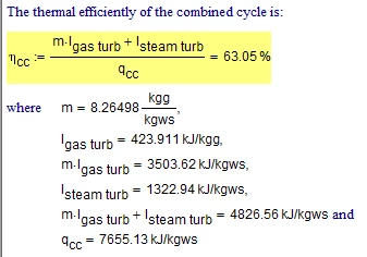

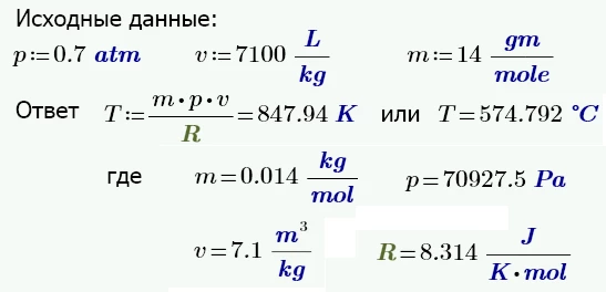

I do not use explicit. It is impossibly with units.
I do so:
November 18, 2010
Like below?

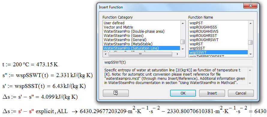

The main and fatal problem of the Explicit operator is that this operatot is one SYMBOLIC tool.
But symbolic tool of Mathcad cannot work with units, number formating tools, DLL-functions etc.
PTC must honestly say it to Mathcad-users!
But each serios Mathcad-sheeet must have units, DLL-functions etc
Two Example.
A Little task - a little problem
A big task (with DLL) - a big/fatal problem:
November 19, 2010
Valery,
Is this a bug?
Mike
November 21, 2010
No. The symbolic processor does not understand units. It just sees mm and in as undefined variables. It's no different to writing 1*sakjas+1*sakldjka. It drops the numerical value because it's 1 and displays sakjas+sakldjka.
