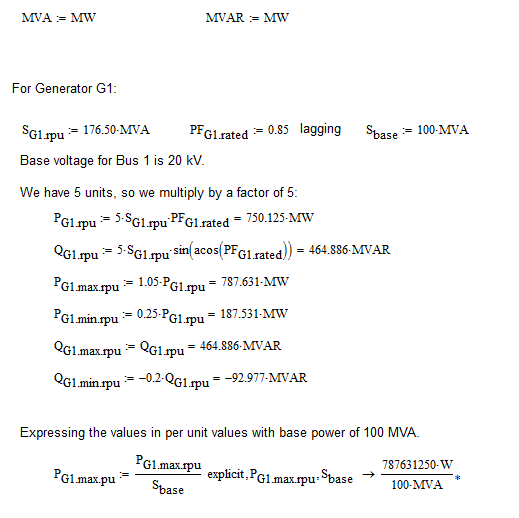

I am using the explicit term to write out the variables in a fraction. The variables have been previously defined but I am getting an error stating the variables are undefined.
March 26, 2012
You need to split it up. The equals after a variable definition is suspect with some items. It was a new feature in MathCAD 13 (I believe) and hard core people on this forum will not use it.
March 26, 2012
Rehan Momin wrote:
...I am getting an error stating the variables are undefined.
Could you provide a screenshot of this error? I just opened your file in Mathcad 15 M010 and here is what I have:
