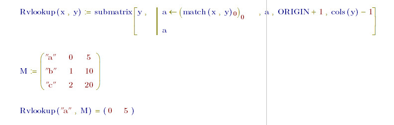

Mine solution:
I have read the http://communities.ptc.com/message/268914 , and I think "BBP" needs this function.
Jan 17, 2015 3:21 PM UTC
Or something like the attached which I had created but Richard was faster 😉
The main problem Bryan had, as I understood, was that he has multiple tables to pick values from.
Anyway - he seems to be happy with Richard's solution.
BTW, if you want to make your approach ORIGIN-aware (and I think you want as you used ORIGIN+1), you should not use index zero in match() or column number "cols(y)-1" in submatrix().
