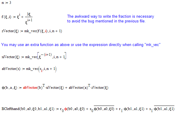

There is a problem with your sheet as the three Vector functions at the top won't consider their argument. If you look at the coefficients at the end you will notice there is no "b0" or "b1" showing up as it should. You have to follow the definition of those functions immedeatly by a symbolic evaluation to make it work. You may then omit that symbolic eval at the definition of Phi, as it would not be necessary there anymore.

As I found the easy way to avoid that Mathcad bug find attached a more streamlined way to deal with your symbolic vectors. Hope you find it useful.

OK, the last one. This shows how to get around the limitation of the last one of not being able to evaluate numerically.

I've had a go at simplifying the worksheet also (I need to get a life!) - see attached.
