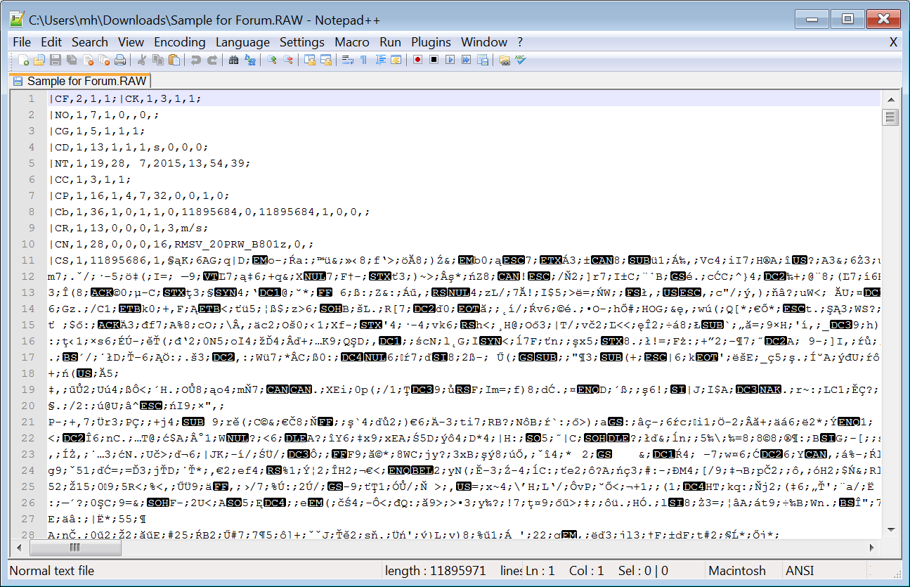

Hi everyone,
is it possible to read (import) FAMOS raw data into Mathcad?  eventually with some kind of script?

Attached are
a) the descriptions I have (please note, the file is NOT produced by FAMOS, it has just FAMOS-Format but is produced by measurement equipment of a supplier)
b) an example of a small file that I would like to read
And I am sorry for asking not so clearly.  My willingness to write software is also limited, unfortunately .  What I am actually asking is if there is a "black-box"-like solution, something almost ready to use, that I can try to use.
thanks again for any hint
Regards
Claudio
August 31, 2016
Sample for Forum.RAW is binary file. This means you cannot open it in Mathcad.
Try to get the file in text format.
MH
August 31, 2016
Hi Martin
thanks, I am aware of that.  That is the first thing I tried, to open with Notepad++.  So probably my question does not make sense.
One never knows, there could have been some tricks, or someone could have already developed a small program.
At least in german-speaking Europe the FAMOS software seems to be well known.
Best regards
CP

If this file is representative of the data you're looking at, then writing a parser should be fairly straightforward - it's what I had to do to convert the initial parts to the nested array shown in my previous message.
READBIN should allow you to read in segments of data rather than reading in the whole thing (READBIN("file", "type", [[endian], [cols], [skip], [maxrows]]).  Use [skip] to get to where the segment starts and [maxrows] to determine the size of the segment (eg, READBIN("file", "byte", 0, 1, 2000, 1000) to get a block of 1000 bytes starting at the 2000th byte) - I've used this before to read chunks of large files and, if you find the starting point for the CS raw data, you might even be able to set type as "float" to simplify the process).
Stuart
September 1, 2016
Thank you Stuart and Werner
you have helped me a lot.  I will try my luck with READBIN and with the trick of skipping and reading "forward", if I can find the time to invest for this project.
But at least I have now two answers, that I was looking for.
a) there is no ready-made solution for reading FAMOS formatted data (as for example for WAV or JPG, BMP files).  Also not available a third-party solution.
b) with an acceptable amount of programming it is possible to read the file and decode it.
For the moment, I just say thank you
Claudio
