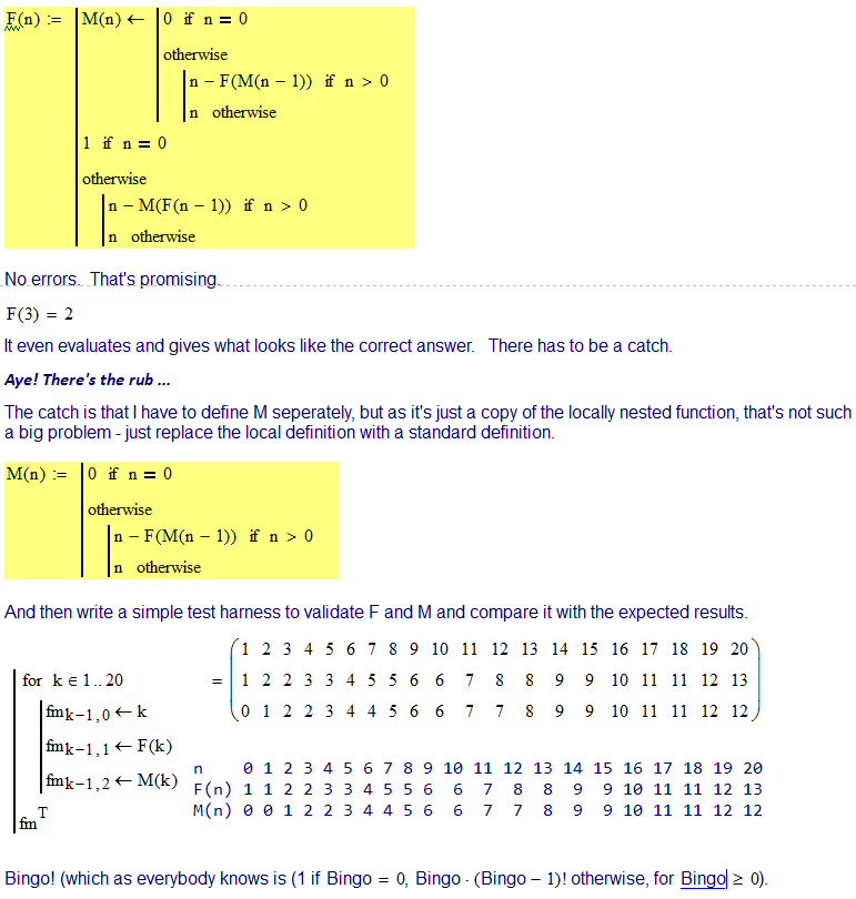

I shall have to give up this thinking lark.  No sooner had I put the keyboard down on you, than I wondered if I'd missed a trick in my previous attempt to use local definitions.  If one is willing to live with the burden of defining one function twice (ie, locally and at worksheet level), then it might be possible to trick Mathcad into allowing mutual recursion.
Stuart

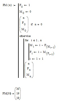

Jul 7, 2015 5:05 AM UTC
Nice little challenge.  F(0) through F(n-1) have to know to calculate F(n), same with M(n).  M(n) can be calculated before F(n), provided F(0) through F(n-1) are known.  See attached code and check my logic.
Cheers
23-Emerald V
Jul 8, 2015 12:21 AM UTC
Cheers
It seems to work ... see attached worksheet.
I tried to but now
Stuart
