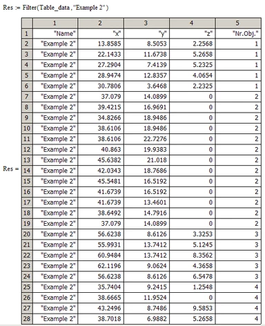

I have a table (table_data) that contains a large number of rows in which the coordinates of X, Y and Z of several objects named POLYLINE and LWPOLYLINE are found.
I need to extract the values of those coordinates, sort them in a table and indicate which belong to one object and which belong to the other.
To better understand what I want, I attached an example of what I want to do automatically, since I do it manually and it takes a lot of time.
In advance thanks for the help

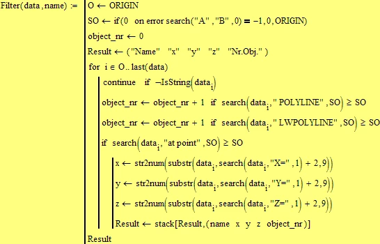

Here is a quick hack, assuming a well behaved data file (sorted, consistently formatted, ...as mentioned above) and without error checking, etc.

Hmm, it would also take some time to write the little parser you need and you would need some additionals informations like
.) are POLYLINE and LWPOLYLINE the only identifiers for objects?
.) Your write that you need to sort the data and indicate which belong to which object. Does that mean that the source data may be not sorted like the one you provided? Can it be that the points are scattered throughout the file and we have to look at the "VERTEX    Layer: " ????" " label for each set of coordinates to see which object that point belongs to.
.) is it for sure that every line with coordinates has the text "at point" in front?
.) can you guarantee that after "X=" etc. the number takes always up exactly 9 characters? Or can you run into a file with more or less precision, too? A fix number would make parsing easier of course.
