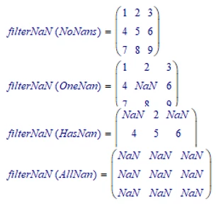

Raiko,
the following function definitions were in the Data Analysis Extension Pack 'electronic book' for Mathcad 11:
(NOTE: Bad programming because not ORIGIN-aware.)
I added:
Gives these results:
Hope this helps. If yes, you can just override the Mathcad 15 internal definitions...
Attached is a mathcad sheet with ORIGIN-aware versions.

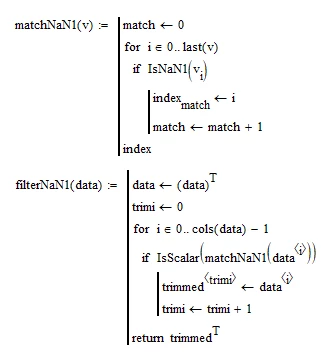

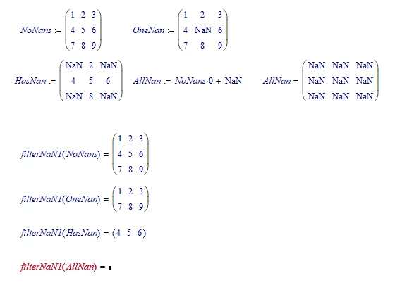

May 16, 2018
This is what I get when I recalculate your sheet with the current MC15. Obviously the function returns the unaltered argument.
Will have a look at it as to why later. Found it. Its your IsNaN1. Replace it by IsNaN ant filterNaN1 works OK.
FilterNAN1 shows the same behaviour
May 16, 2018
According your matchNaN:
a=NaN does not give you 1 even though a is assigned NaN
Replace "...if (Vv=NaN)" by "...if IsNaN(Vv)" and your filterNaN works OK, too.
Don't use IsNaN1, as otherwise matchNaN will return 0 all the time. 0 is scalar and so every row is included in the result matrix.
