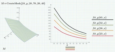

I have two data sets that I can curve fit to get polynomial equations for. These are 2D data sets for temperatures of 23C nd 65C. I want to find the equation of a curve at 52C based on these two curves. I could interpolate between each value and generate a new data set piece by piece, but hopefully there is a better solution? Any help woudl be greatly appreciated. The data sets are attached in Prime 6.0
Thanks in advance!

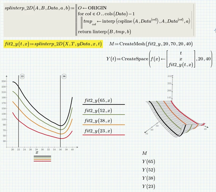

I added spline interpolation to give you an idea what it looks like and why I suggested to stay with linear interpolation.
You could change "cspline" to "lspline" for a less oscillating curve, but I guess that there is no benefit in using spline interpolation.

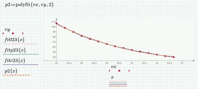

Remark: You talked about "polynomial fit" and even though I called my function (wrongly) "fit" it is NOT a fit but rather an interpolation, no matter if linear or spline. A polynomial fit could be obtained using polyfit, but the resulting curve normally would not run through a single single one of the 15 given data points (unless you chose a polynomial of order 14) but will be a good overall fit. Here an example to fit the data with a simple quadratic parabola:

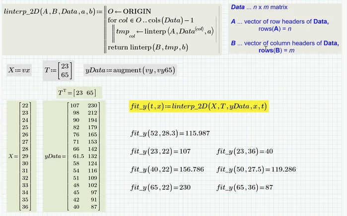

Here is an utility function you might find useful.
It uses linear interpolation only and I think thats all you need as you don't gain any value by spline interpolation. But of course it would be easy to replace the linear interpolation by a spline interpolation. Only the first one, as for the temperature you would have to stay with linear interpolation as you only have two values.
P6 worksheet attached
