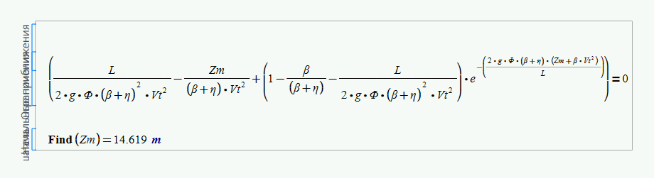

find function not working
in the attached file zm will be around 14.6
with find function, i am unable to solve and find the value of zm
Best answer by ValeryOchkov
You type Given and Point.
Delete this point please and no problem.
A lot of Mathcad uses type space after Given and convert this keyword into a remark.
It is why we have not now Given in Prime.
And the second.
If you have only one equation better use the root function not Find one.
October 8, 2013
When working with the units is better to use Mathcad Prime (worksheet for Mathcad Prime 3.0 can be found in attachment).
October 8, 2013
There was something wrong with the word Given (not sure what!). Just delete the word Given and retype it. Your Given...Find solve block then works just fine.

October 8, 2013
Alan,
i deleted the equation and again retyped
but it is not working, it showing Zm is not defined again
i am using mathcad v 14
And the second.
