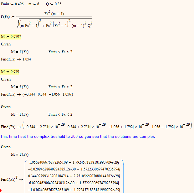

Hi all,
I have a solve block as follows in MathCAD 15.0:
m=6
Fmin=0.469
Q=0.35
I included the constraint line to limit the solution to within the range of 0.469 to 2, but I do not understand why I would get solution which is outside this range, such as 0.345 and the negative numbers.
Could someone please help?
Thanks!
-Alan

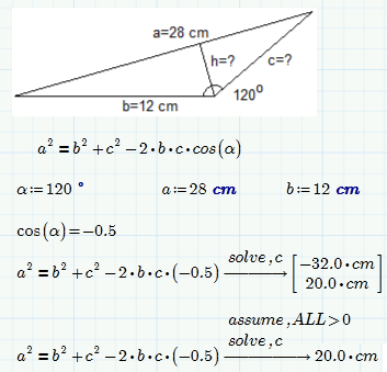

Is there any reason you must use the symbolic solver? Numerically, you get what you want right away:
Alan

Two things:
  1. Fx is never seen in the equation, only as a square. So you can reduce the complexity of the problem
  2. You never specify M
Having said that, there's a fairly small range of M for which you can find a solution:
November 20, 2013
For future questions please attach your worksheet!
You didn't reveal the value of M and this is exactly vital as you will see.
Mathcad symbolics quite often has its problems with constraints being inequalities, but in your case thgis seems not to be the problem.
There is nothing wrong with the solve block.
Your problem seems not to be that Mathcad is not following your constraint but that your solutions are complex numbers with a very small imaginary part. Thats why a comparison with real numbers in size does not make sense. You don't see this because you had set up to display 3 decimals places only.
See the attached sheet for further details. I guessed the value of M from the solution values you showed and only a very slight modification of M yields real values and then Mathcad respects your constraint.

November 21, 2013
Hi all,
Thanks for the quick reply. It seems like I forgot to include the M value.
In the case, M=0.988.
Alan
November 21, 2013
No particular reason, and thank you! I think this is the problem I was having.
