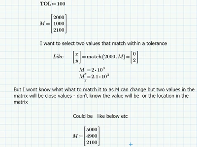

Thank you for that. How can I also choose one that does not match?
Not sure what you mean???
All the combination of two indices which are NOT in the list my program return correspond to values which are farther apart than the tolerance given.
