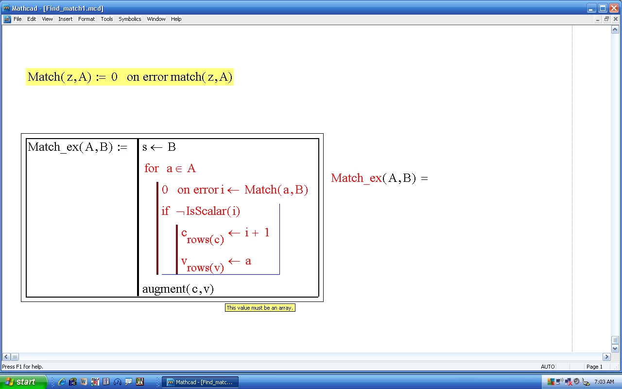

I have a question need help. This question is similar the one in the past.
( Find the indices of the same numbers in the other set ? )
( or similar output like the above. )
Thanks in advance.
Regards, -LL-

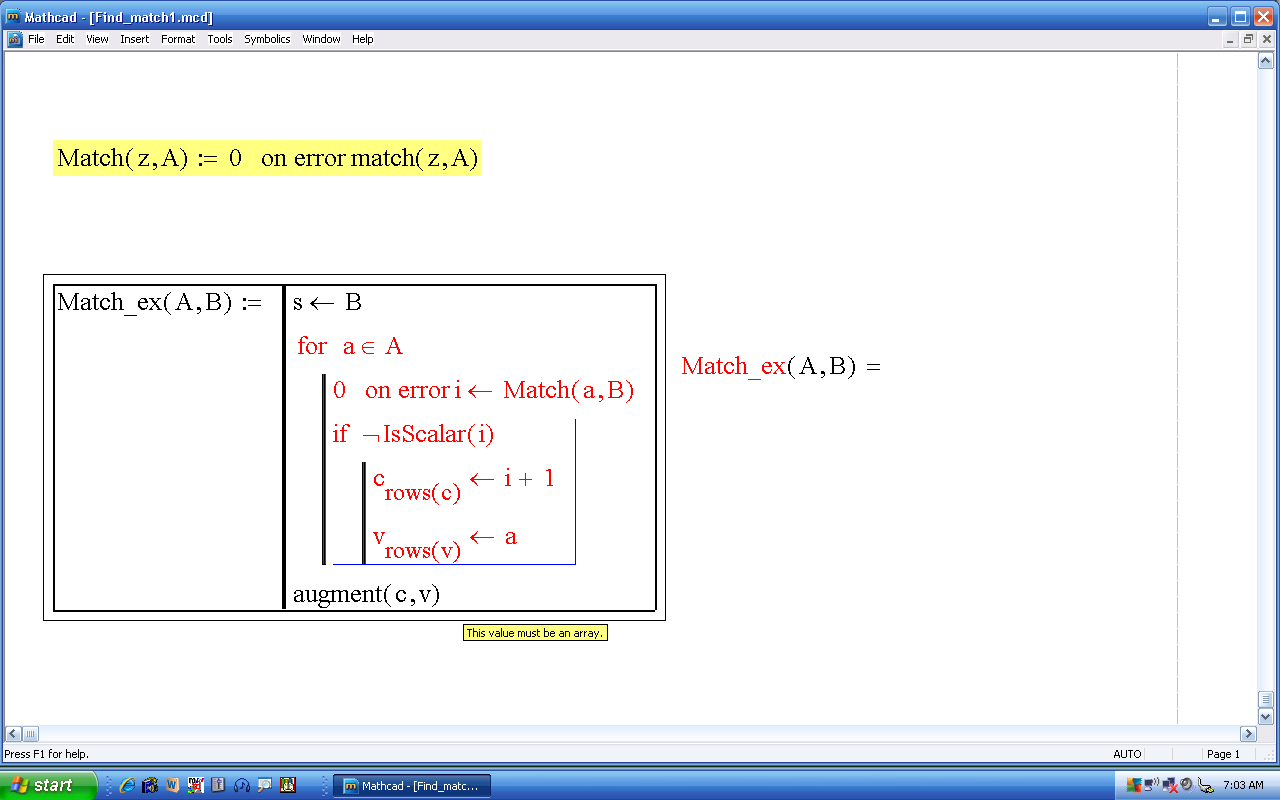

Mike,
My Mathcad 12 can not read that function, and show as the following :
Thanks again. Regards. -LL-

October 22, 2010
Try this one
Andy
lvl10720-TurquoiseAuthor
20-Turquoise
October 22, 2010
Andy, I have learned a lot of new thing from the function you wrote here. Thanks a lot indeed.
