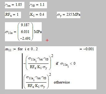

Hello. I am looking for some assistance with for loops and matrices within Mathcad. I have a relatively basic knowledge of mathcad so this may be a straightforward solution.
I am trying to return a value for m11 for each of the sigma(11) values. However, the way i have it set up, it only returns the m11 value when i = 2.
I know i could list the equation out 3 times, changing the "i" with 0, 1, and 2 each time; however i had thought i may be able to do the same thing using the for loop function.
Thank you.

A Mathcad program returns ONLY the value of the last statement executed. That's why you see a single element instead of an array.

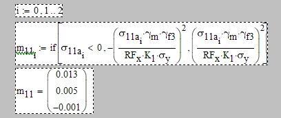

But in general I prefer to define a function (prevents strange things happening when the FOR loop gets out of sync with the length of the array):

two other possible ways ...
Thank you for this. Capture 1 works best for me as it was very similar to how the actual calculation I have was laid out.

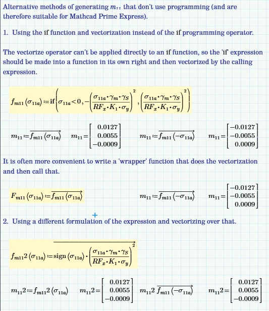

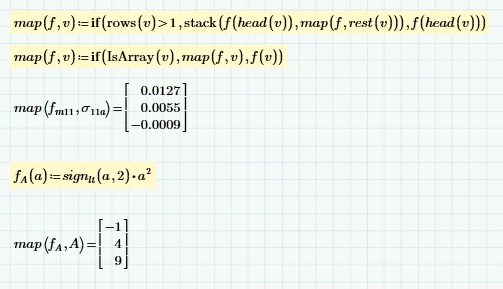

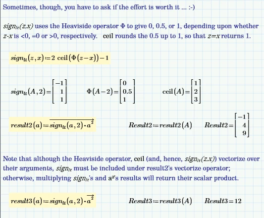

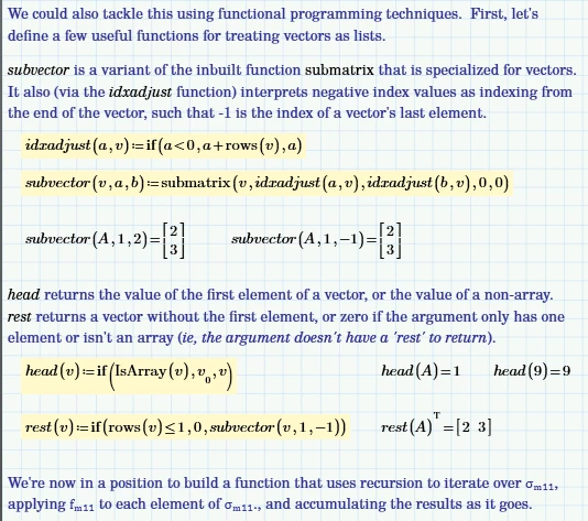

For those who have similar problems but only have Mathcad Prime Express, here are a few other ways around using programmed for loops.  They work in Mathcad Prime Express 7 and should work in earlier versions.
