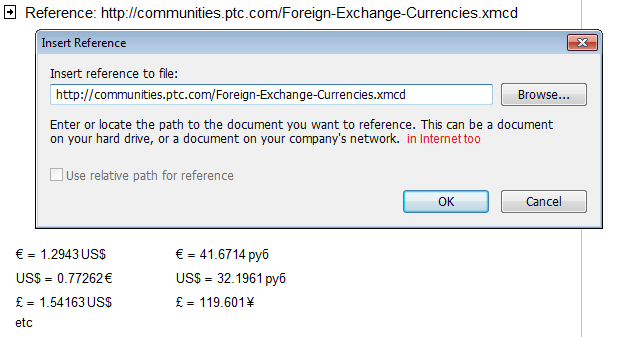

One way to the solving this problem - a Reference on the special sheet on PlanetPTC.
I do so for solving the problem of the inserting functions of materials properties in Mathcad-sheets:
see the article - http://twt.mpei.ac.ru/ochkov/WSPHB/Ochkov-Znamensky-Web-Rankine-Eng.html
and the video - http://www.youtube.com/watch?v=Gwv2vfNR-3o
When I have new data of materials properties I change this functions and my customs have only fresh data!
PTC team or some others must automatically change currencies rates in this sheet with name Foreign-Exchange-Currencies.mcdx and all Mathcad-users can have fresh rates!

Hello, Valery --- thank you for your post; I will definitely try this and post here my result.
