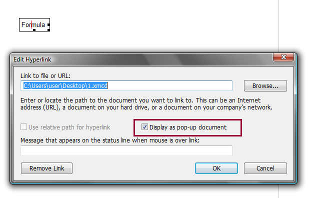

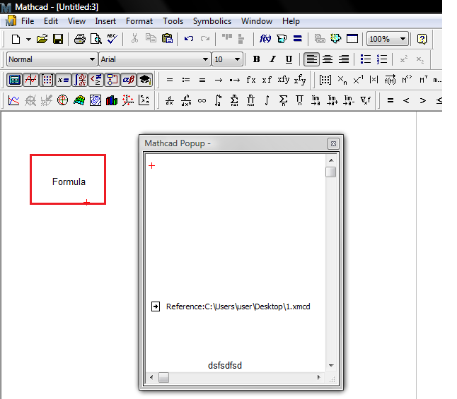

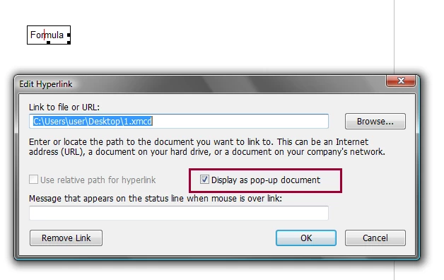

As one of the solution of this problem - to use "Hyperlink" to another worksheet (in main menu go to "Insert" -> "Hyperlink") and when you edit a hyperlink you need to choose "Display as pop-up document".
1. Insert "Hyperlink":
2. Edit "Hyperlink":
3. Display pop-up window:
