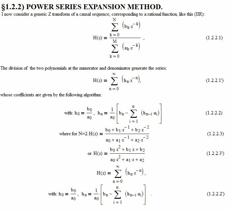

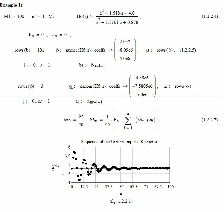

the following two photos illustrate the algorithm of the synthetic division and an example (you have only to change z with s):

Hi Topaz,
Thanks for your reply but this is not exactly what I am looking for. It is not as simple as replacing z with s.
To find the Cauer parameters the quotient of each iteration gives the value of one component and the remainder is used for the next iteration.

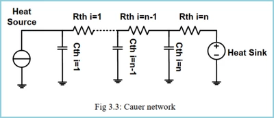

October 8, 2019
Yes they will be 5th order Cauer networks like this:

April 29, 2020
Reviewing the algorithms related to the networks of Foster and Cauer, I came across this worksheet that I made symbolic, see attachment.
