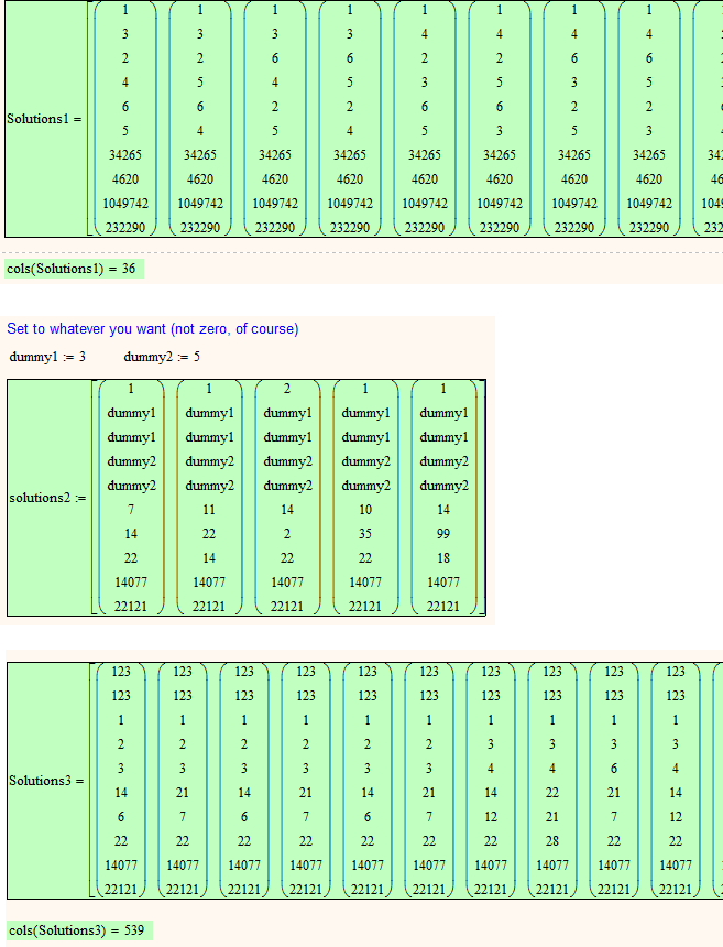

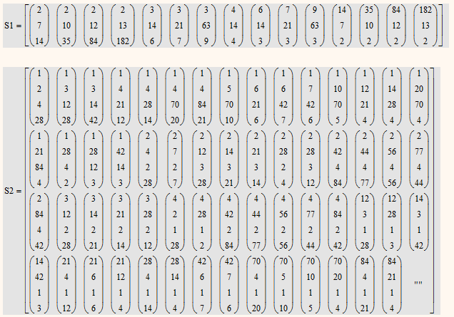

Guess you would have to write some routines to try "all" possibilities.
Using a generic brute force program I wrote some time ago I found some solutions for your first two problems.
Solutions with the smallest possible integers are
but if you allow bigger integers you get a lot more solutions. Below are the solutions for task 1 with integers from 1 to 200 and task to for the range 1 to 100.
As for the third problem, the denominator 2011 is a prime and so without amore intelligent algorithm we would have to try all numbers from 1 to 2011 at least. Probably there would be no solution found and we should try up to integer multiples of 2011. Trying all numbers from 1 to 2011 would mean we have to try 4^2011=5*10^29 times. Based on the timing with a smaller range this would take on my machine about 10^18 years!!
So problem 3 would require more thinking and less brute force.
Addendum: Here is one (of sure many) solution for your third problem, found by a different method, of course

In the meantime you should know that Mathcads solve block can hardly be convinced to give integer solutions and you would have to write some program routines to get solutions - which is sometimes possible, sometimes not.
Why don't you attach a sheet to show what programs you have tried so far?
