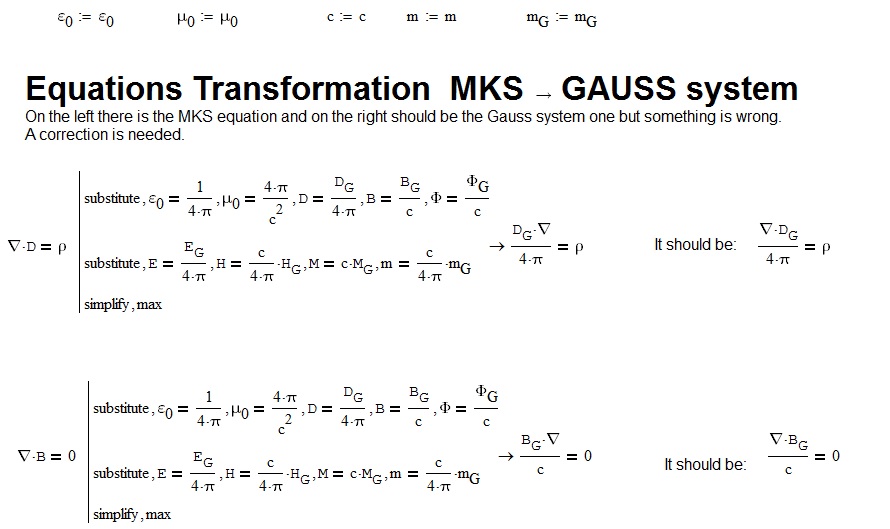

Goodmorning everyone!
Is there anyone  who can fix this little problem?
Thanks a lot.
F. M.

Thinking about it, with regard to the divergence operator, since I used the dot product, which is commutative (while the vector product is not) the program (considering both arguments as vectors) swaps the operator (seen as a vector) with the vgiven ector. Swapping that is not valid for the vector product.
December 7, 2015
You are right, that you can omit/delete the placholder for the variable in the gradient operator. But it seems that you deleted the placeholder for the function, too, and so you end up as Richard already stated with a simple variable. You see the multiplication dot between the nabla-symbol and the variable D or B.
I am not sure what you expected the nabla-symbol to be. Mathcad obviously gives you the result you expected anyway as the order of the operands in a product does not matter.
-MFra-21-Topaz IIAuthor
December 7, 2015
Thanks for the examples. I know what is written in the guide, and I've taken into account.
I use these operators since I was a boy.
The symbol is called nabla and it defines the gradient operator acting on a scalar.
Similarly to what is realized in mathcad for it, I would like to define the other two vector operators with the use of nabla: divergence and rotor that act on vectors.
December 7, 2015
The answer of Luke Meeks would be fine if I did not want to use nabla. That, however, I will. So far, there is no right answer.

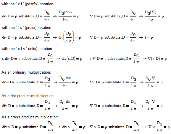

I think the closest you can get is to use the cross-product operator:
And I find the prefix notation result, with the nabla operator, intriguing.

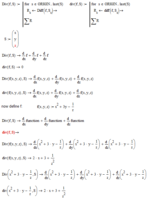

OK. the nabla symbol is not available in Mathcad 11, but,
using the undocumented symbolic functions Diff() and diff()
that produce respectively calculate (partial) derivatives of
the (assumed function) first parameter to the second parameter:
you can get this:
For those who can benefit from it.
