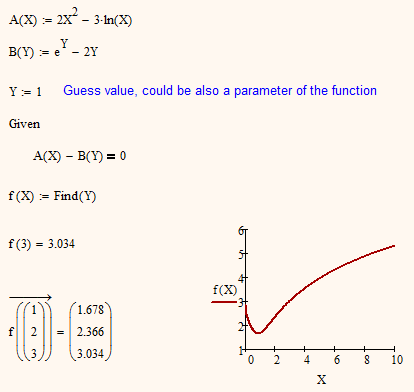

Hi all,
This might be an incredibly basic question but I'm a newcomer to MathCAD and a bit stuck...
I'm looking for a function that will independently solve a set of equations for me - so, for example, I have equations in the format
A(X) - B(Y) = 0
Where A and B are further functions of other variables. Basically, I want to have MathCAD return the values of Y (to make the above true) whilst I'm varying the value of X (as vector input values).
All of the functions I have used so far have been about solving a set of simulataneous equations. I've been trying to use the "Find" function but I'm not having any success using it for independent equations....
Hope that's not too ambiguous and someone can help.
Thanks!
Best answer by Werner_E
Something like this?

Werner_E25-Diamond IAnswer
October 9, 2013

Aha!
Apologies for the confusion - I wrote this at the end of a very long day and had been struggling with the problem for a while!
What I was after was (apparantly!) the "vectorize operator" - thanks a bunch!
