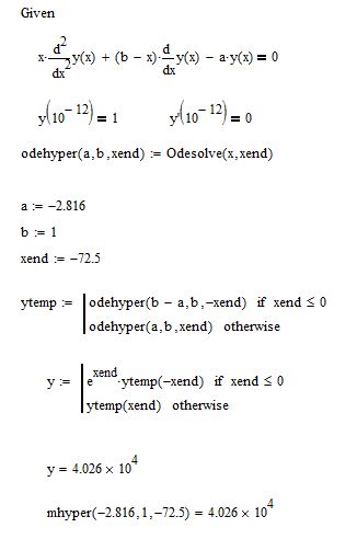

If you want a reliable function form, you could always just solve the ode:
That said, I haven't investigated the limitations of this approach!
Alan
May 9, 2014
Thanks for the responses.
In my case, the xend is less than zero so I had to use a tweak. See below.
I too am not sure of the limitations and robustness of the ODE solution. Pearson (http://people.maths.ox.ac.uk/porterm/research/pearson_final.pdf) indicates that it may not be accurate over the full range of parameters.
May 9, 2014
That works, though simpler just to make initial x-value negative:
Alan
