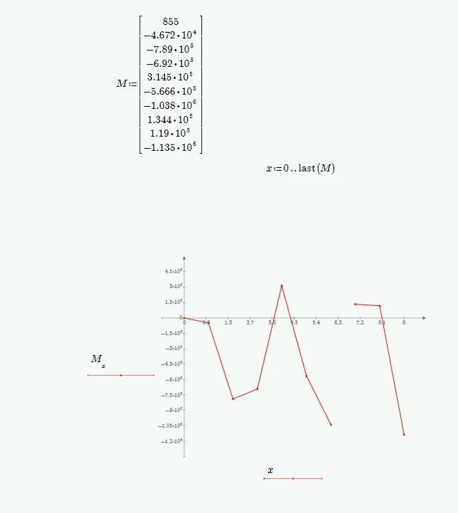

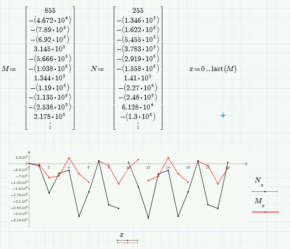

I just installed Prime 2 and a plotting bug I've seen in Prime 1 is still there. Attached is a worksheet with some data points I grabbed from some simulation data to illustrate the point. Here is a screen shot of the worksheet:
Notice the missing connecting lines between several points in both plots. What is happening, and is there a workaround?
Gerrit
March 22, 2012
Just noticed that it seems to have to do with zero crossing. Offsetting the plots to one side or the other of the zero axis fixes the problem.

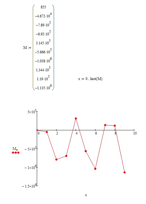

March 23, 2012
In Mathcad 15 M010:
