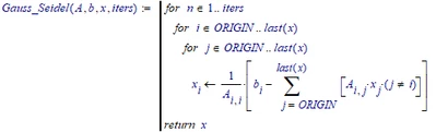

LucMeekesAnswer
February 9, 2022
The (j<i) and (j>i) serve to exclude the item in the sum where j=i,
What you need to understand is that (j<i) is a boolean construct that results in 1 if j indeed is smaller than i. As soon as j=i, or is larger, the value of (j<i) becomes 0, so effectively the summand is zero'd for this indices. Likewise for the second sum uses (j>i) to set all summands to zero when j=i, or less.
There's another way to simplify the program:

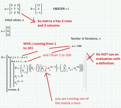

January 28, 2022
Here are some first comments:
January 28, 2022
The number of iterations was just random. Correct me if I am wrong. The ai,j is having a hard time because it has a big number of range. Am i right?
My i represents the number of rows and the j represents number of columns (including the augmented matrix).
If I lower my matrix number n=3, it still has the same issues. I fixed some of the values from my file earlier.
Kindly enlighten me on my program. Thank you.
January 28, 2022
Nope. The a[i,j is having a hard time because even with n=3 you're trying to address elements out of a's range. Note that you're running j up to n+1, which is 4.
"including the augmented matrix" I don't see you augment the matrix.
And finally, you are raising elements of the array x to powers N and N+1. I don't think that the Gauss Seidel method needs that...
