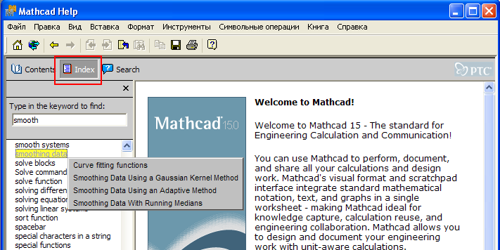

Try to use for your function a method of smoothing of the data. See examples in attachment. Also look at "Mathcad Help" (hotkey F1) in the search for the keyword "smooth":

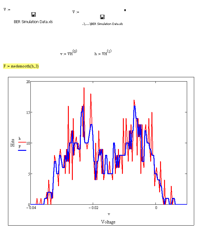

And here that turns out with use of the built in function of smoothing "medsmooth(Y, n)" ("n=3" - the parameter defining number of windows of smoothing into which the interval will be divided at data analysis ["n" can be only an odd number, strictly smaller amounts of elements in sampling]):

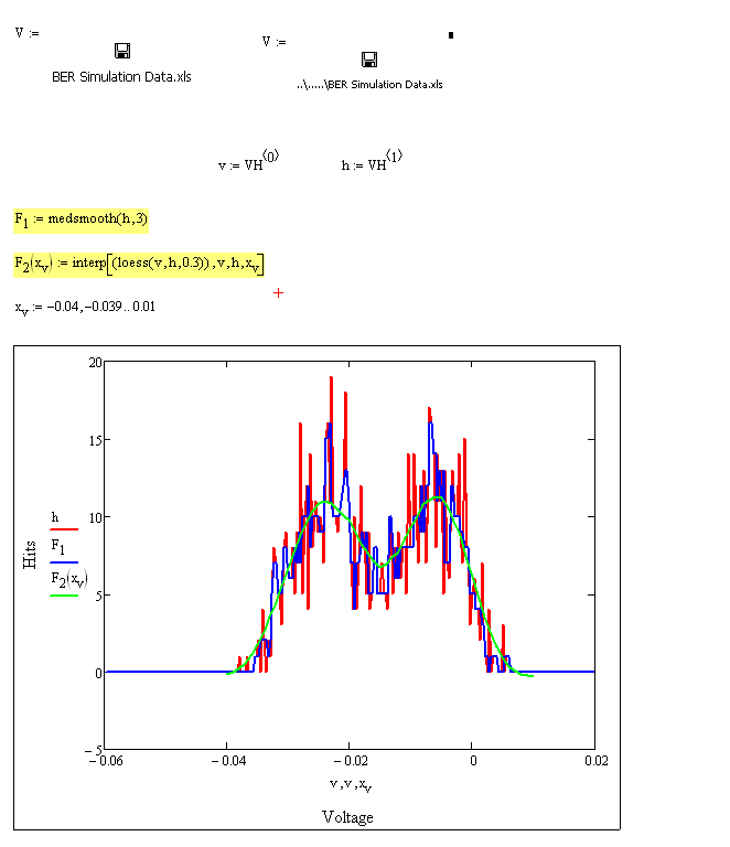

Another variant for the given task is to use of a regression with usage of several segments of a polynomial (with usage of built functions "interp" and "loess" [thus, the parameter "span=0.3" here is used - sets a level of a smoothness of the data, in practice "0.2 <span <2"]):
