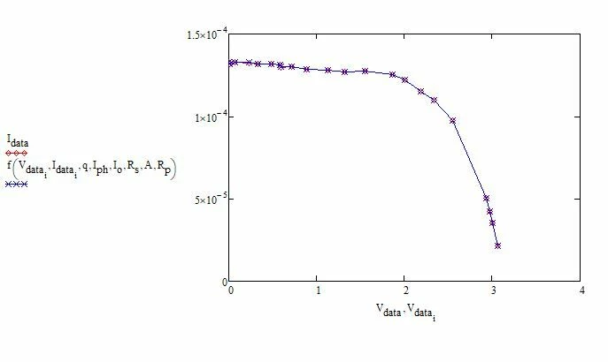

genfit() to solve for nonlinear parameters
How to use genfit() to solve for nonlinear parameters since it is hard to separate I or V from the equation?
6 replies
July 11, 2021
genfit will not fit a function of two variables?
You need six constants to solve the problem.
Here is a solve block that gets close.

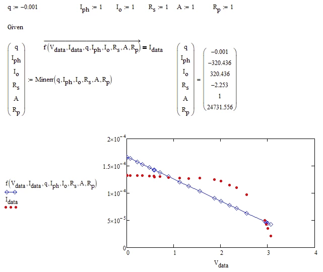

July 11, 2021

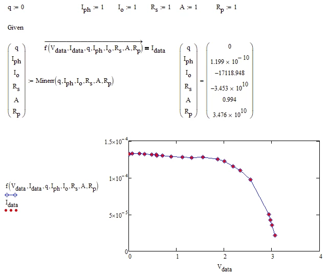

Why not consider ALL data and use "minerr" instead of "find":
But the result is only satisfactory if the guess for q (which does not seem to be changed by the solve block) is set to 0:
The whole thing is quite dependent on the guess values - as an example try changing the guess for A and look how the other values change.
July 11, 2021
In this equation you cannot choose the value of q freely.  It's value should be the electron charge (while k is the Boltzmann constant, and T is the absolute temperature). It makes that k*T/q is about 25 mV.

July 12, 2021
For completeness sake here is solution with q set to electronic charge value.
